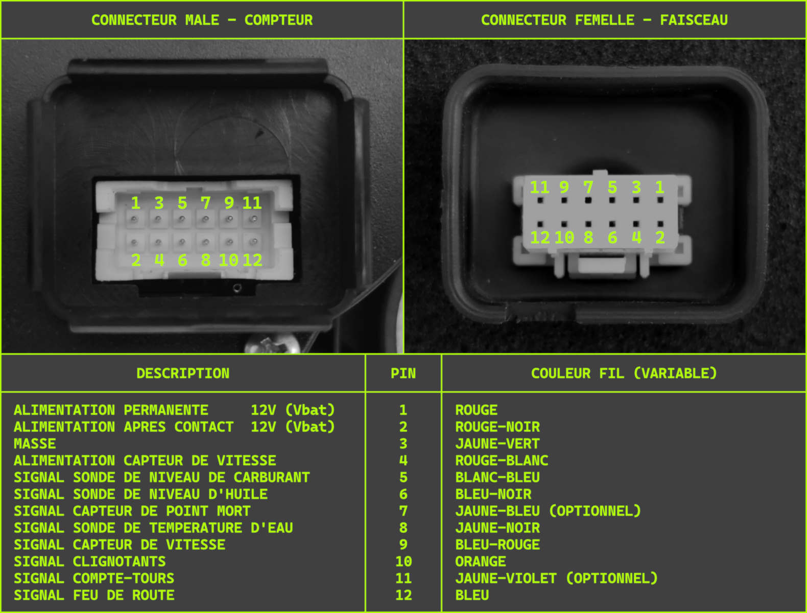

Hello,
It could be a power problem to the dashboard, even if the indicators are working.
Engine stopped, unplug the dashboard and check voltage between pins 1 and 3 of the female connector (image to the right), you must measure the same voltage as on the battery terminals, around 13.5V if the battery is in good condition. If not, you have a problem somewhere on the wiring harness.
But most likely, the dashboard is damaged and need to be repaired. This is a common problem when the dashboard is used for some time without a battery, or bad battery, blown fuse, maybe broken wire... The dashboard is then powered only by the 12V regulator, which doesn't produce a steady supply voltage, it damages the dashboard after some time.
